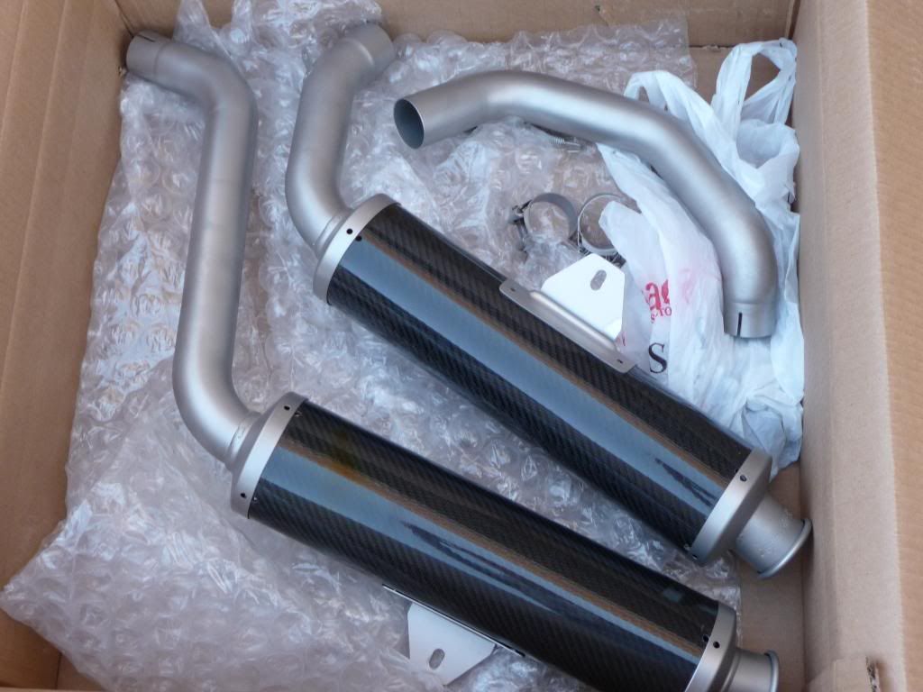

I bought this system used from a member here.  He had disassembled it and had it bead blasted as he was going to have it ceramic coated.
This is how it came.

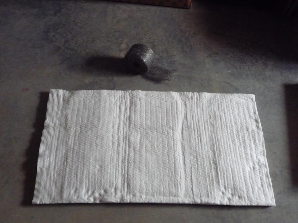

So by looking at their photo and info provided by the previous owner, I bought the following
1# roll of AISI 434 Stainless Steel Wool, coarse
(1) 2ft x 3ft x 1inch thick Superwool Blanket (a synthetic ceramic fiber blanket, used to line kilns)
You will also need (24) #10 closed end rivets and a rivet gun.

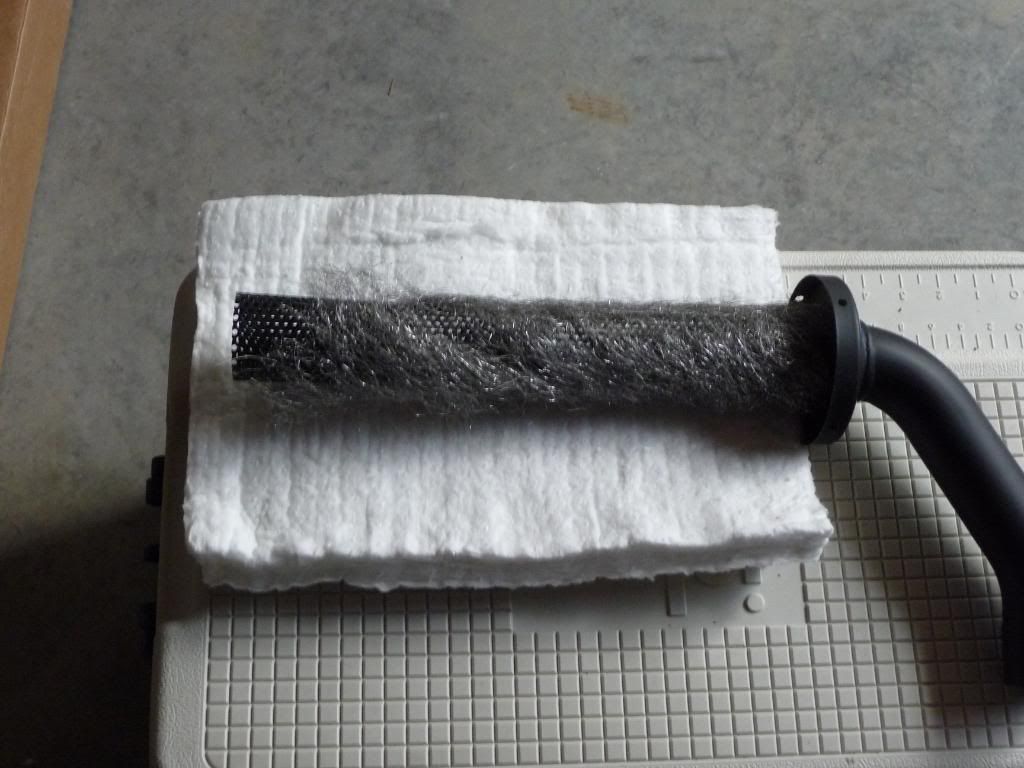

The Stainless Steel Wool and the Superwool Blanket.
Put on protective gloves before handling the fiber blanket and a dust mask if you desire.

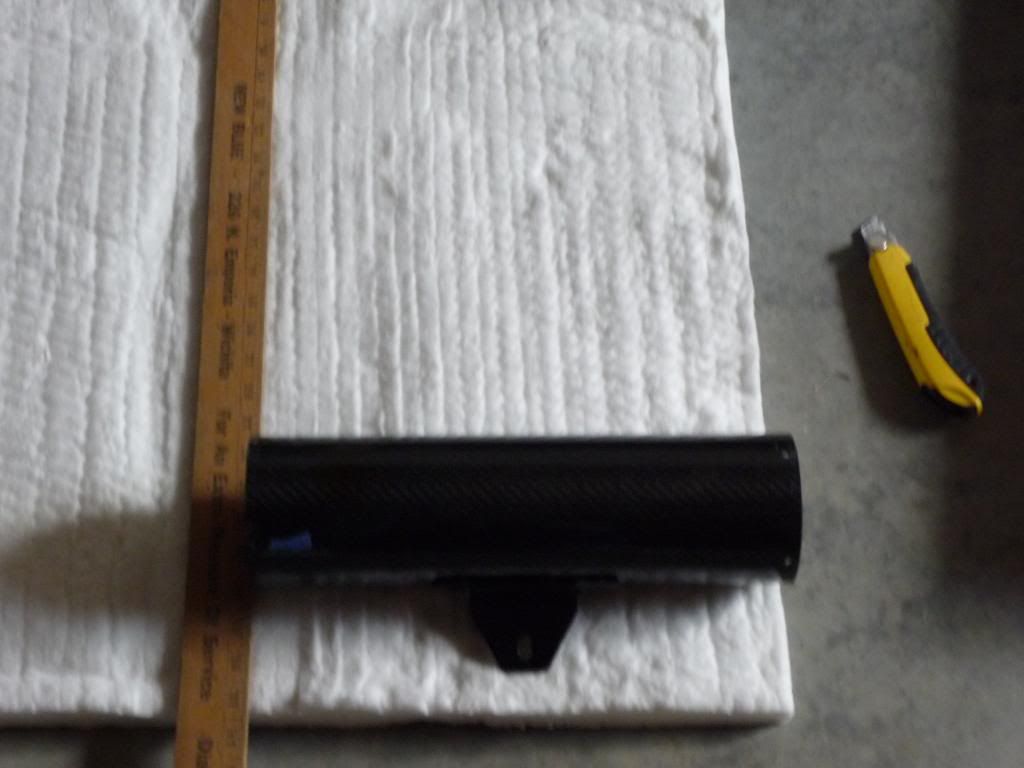

Next cut the blanket the length of the can using a straight edge and utility knife.

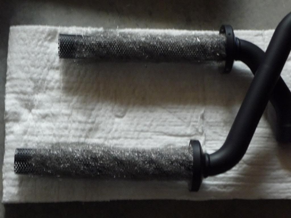

Next cut the steel wool to length, enough to cover pipe.
Allow for end cap to slide over pipe and wrap it.

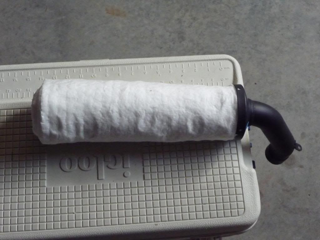

Next cut the blanket to the proper length by a trial roll first, allow for a little overlap.
Roll the blanket around the pipe, no wire, ties, or tape necessary.
Make sure it is stuffed into the front cap.

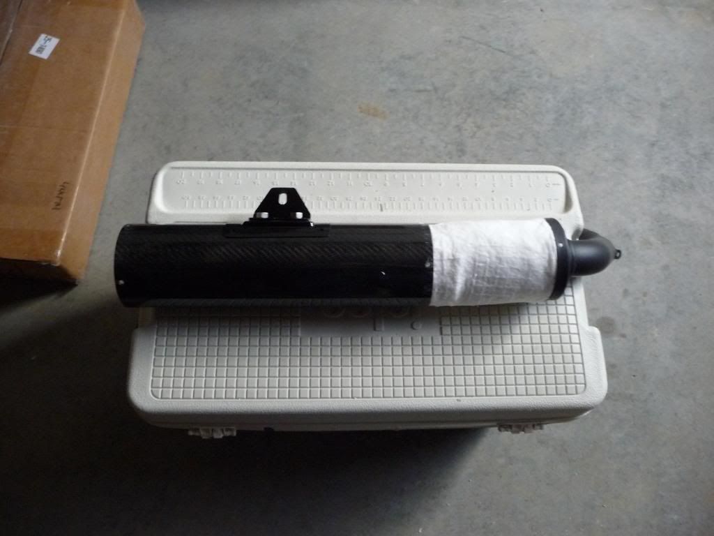

Holding the pipe with my knees, use one hand to keep the blanket tight, with the other hand slide can over blanket.
You can use a twisting motion to slide the can over the blanket.
The hard part is aligning the holes in the cover with the holes in the cap.  The Spark system is very tight tolerance, so I used a little liquid soap to get the CF covers into the caps.  You can use a drift punch or appropriate sized drill bit to get final alignment of the holes.  Insert all four rivets before you begin riveting.  Then rivet away.

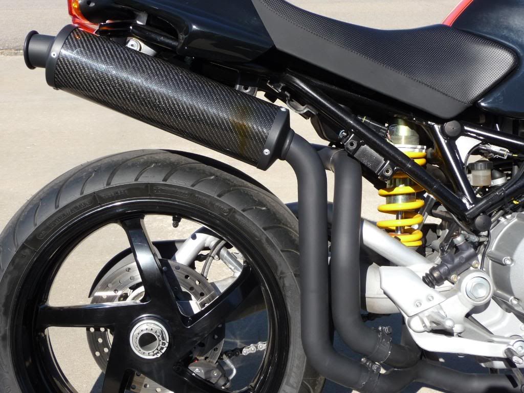

Since this topic is about repacking the cans, I'll leave it to you to put all the pipes back on the bike.
But it should look something like this.
I know, I'll probally paint the rivet heads to match.  But I wanted to hear them.  ;D
The sound is perfect to me.   [thumbsup]
