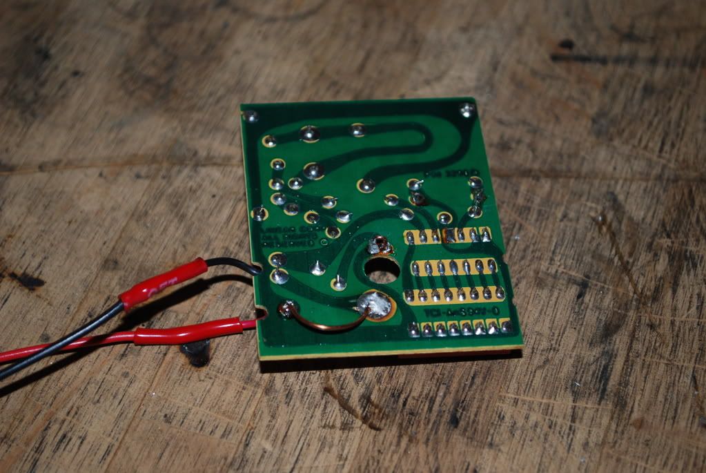

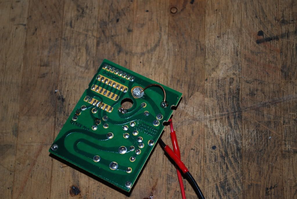

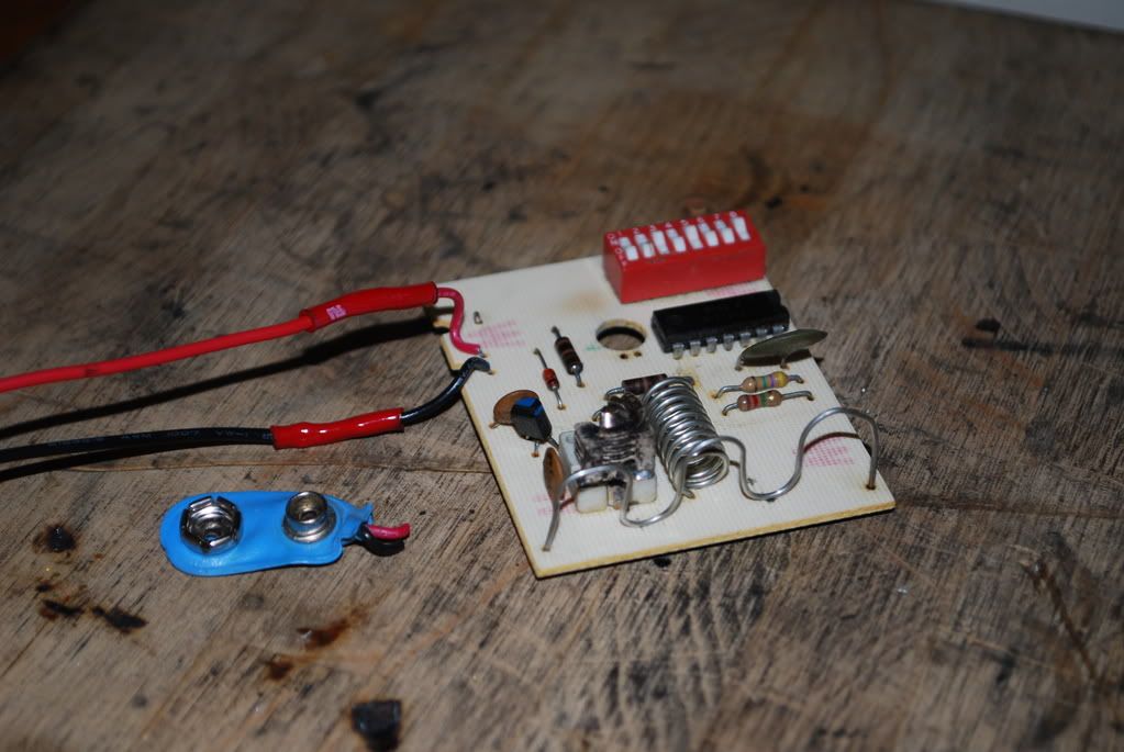

Finally got around to tinkering. I split the cost of a new receiver for my dad's garage door so that I can break his old remote that was falling apart anyway. Started by clipping off the 9V battery connector and soldering on some wires to extend it.
Then I tried just soldering the switch together but that didn't work so I pulled the switch off an and soldered on a wire to close the switch. (wire on the top)
For some reason the thing still didn't work so I got I tried pulling the burnt out light bulb and soldering a wire in. (U shaped wire right by the hole in the middle) Oddly enough, that worked. The remote worked perfectly fine before I started tinkering with it even w/ the burnt out light bulb but whatever.
I tested it and it still works.  ;D
I want to try doing the diode bit so I'm trying to figure out what kinda diode I need. Also trying to figure out the wiring. From the wiring diagram that was posted, it looks like the diode goes between the high beam switch and flasher switch. These are both in the controls and handlebar and I imagine it would be a tight fit to add anything into there but I haven't had the time to look yet.
Also on the list is making a new box for this thing. I'm thinking of taking some plexi glass I have laying around and bending that into a box. I also need to decide where I'm gonna put this thing because I'm not running a stock headlight anymore and I'm not sure I have enough space in there for the unit (it's about 3x3 right now).
Gimpy
You're exactly right on the placement on the diode.  It's a tight fit but you can get it to work.  I used some soldering paste to hold the diode in place (and the correct orientation) and then I heated it up to melt the paste.  As far as hiding the unit itself, I have mine Velcro'd near the battery.  it has a limited range underneath the tank but it is enough.
