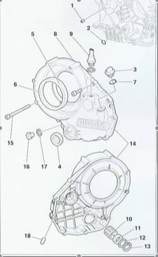

It seems that seal #11 shown in the figure below is 20x30x7mm for most Ducatis.
I have a case cover for which this seal is 20x38x7mm.  Does anyone know which bike(s) have this larger o.d. seal???

I have a case cover (now powdercoated) off a different bike -- now I know its from a 999 with a different, larger, easier to remove seal.
The case cover on my desmoquattro S4R has a seal that is literally wedged between the perforated brass bush and the cover, and neither can be removed.  It is NOT like your testastretta cover.
edit:  the figure in the OP is from an '03 model and has a different seal than my '05.
