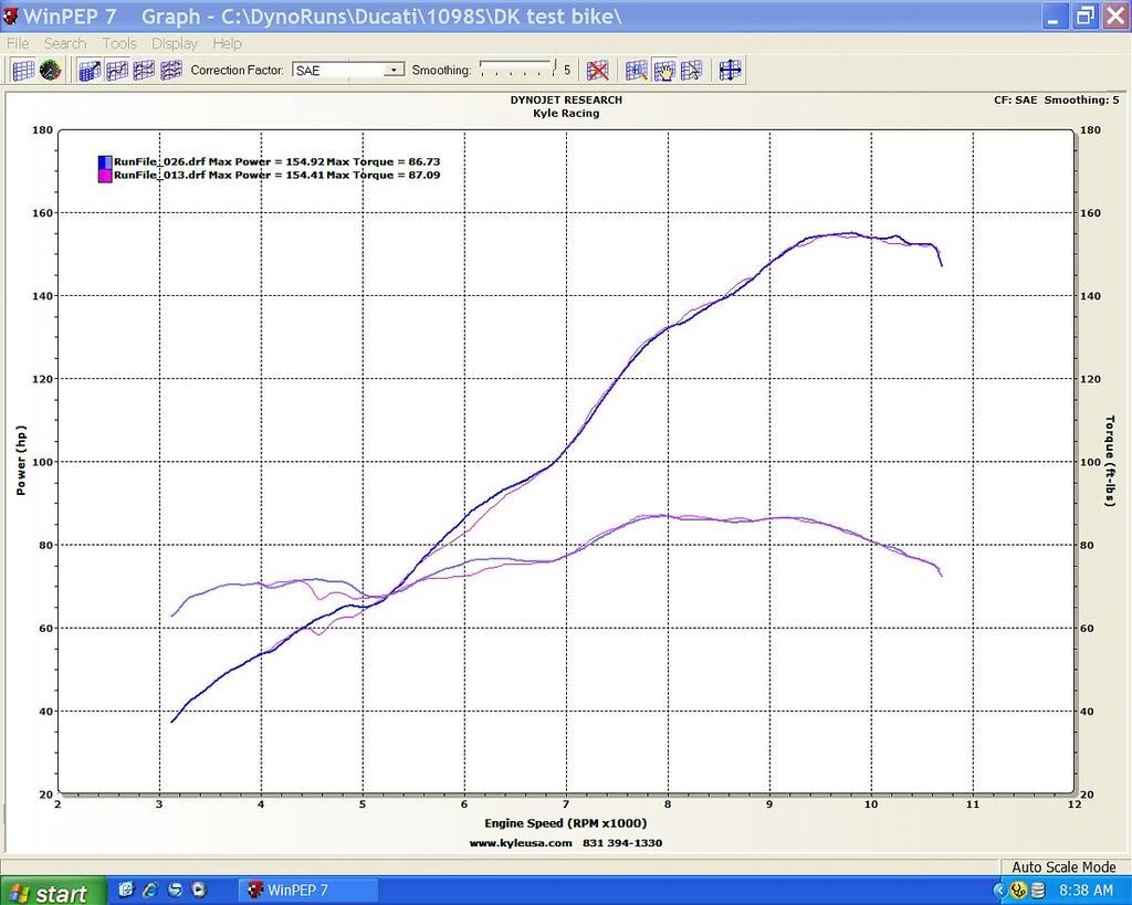

No valium needed here.  Here is a quote from Brad
QuoteI don’t know where the power is, maybe the DP Carbon Termi muffler kit is where it’s hiding.
He has never tested a 1098 without the cats.  Adding bigger pipes to the 1098 and leaving the cats and baffles in place is the same as running an S4Rs with the stock exhaust system, which as you know is far from ideal.
It doesn't bother me if other bikes are faster or if certain people don't like my choice in bike.  I just point out where facts are misrepresented.  Certain things are just a matter of personal preference.  Such as the Monster being a more comfortable bike for you.  Other things are just fact.  Like a fully kitted 1098 putting out more HP and torque everywhere than a fully kitted S4Rs.
I don't have anything against the S4Rs.  It is a great bike for what it is.  But it does not work as well in certain areas that a SBK does.  All bikes are a compromise.
Plan your next vacation in San Diego and I'll let you take the 1098 for a spin.
LA
report and dyno graphs for before and after Termi 70mm exhaust kit (full exhaust system, air filter, ECU)
What does Full 70 mm Exhaust system mean? Cat still in place?
I don't know. Guess we should ask Brad.
How bout it Brad?
By his graphs at 5000 the Testa is making about 57 hp and the 1098 is making about 57 hp. The Testa is making 75 hp at 6000 and the 1098 a little less than that.  At 7000 the Testa is making 94 hp and the 1098 94 hp. At 8000 the Testa is making 110 hp and the 1098 is making just under 120. Same dyno. Like I said to begin with the 1098 has it all over the Testa after that. As it should with 100 cc's more volume and 2 mm bigger valves. It's just closer in the meat of the register than I would have thought and I think that's what Brad was saying. Maybe?

The kit he used still has cats and baffles.  The kit I have is like the one on your S4Rs.  It has no cats or baffles.  I have no idea why he tested that "full system".  The charts I have seen with the real "full system" show a massive gain in torque throughout the entire powerband.  Ride one with the same mods as your bike (full system, no cats, no baffles, DP ECU, and 14 tooth sprocket)  Having an extra 15 ft lbs of torque every where in the rpm range is very noticeable over the 999 motor.
My bike will loop itself in the first three gears at low rpm and lift the front end in third at over 100 mph.  I have ridden 999's and S4Rs's with Termi kits and shorter gearing and they don't come close to the kind of power that this bike has.

brad black
the 1098 exhausts i have tested are:
1/ termi ti slip ons with cats.  you should see them glow on the dyno.  looks great.
2/ termi 70mm full system.  no cats.  just great big pipes that don't work any better than the std ones.
the 1098 midrange hole is due to the exhaust design.  the bimota db7 has a different system without midrange hole.  the s4rs with termi 50mm kit has a similar hole at the lower rpm, but it's smaller in terms of power drop and rpm width, so you don't notice it as much.
it's the torque rise at the higher end of this hole that makes the 1098 in particular and s4rs feel so fast, and why they'll wheelie at higher speeds.  a 996 or sps won't wheelie like that because the torque curve is much flatter.
Thanks Brad,
O.K. Bob, I sent Brad a PM and ask him if #2 line on the charts was a "Full System" and you have his awnser - Yes a "full system", no cats and with the ECU and open airbox. Thats where I got the numbers. I printed the charts and read across with a ruler to get them.

That seems really strange since all the other dyno runs seem to show quite a difference between the mufflers without cats versus the ones with cats.  I have ridden the S4R with high compression pistons, the S4Rs with the 50mm Termi kit, and the 1098 with the full system and the 1098 pulls like the 996 down low and the 999 up top so it is surprising when someone tells me they thought the bottom end was weak.  Without starting a whole different dyno different day argument, I am posting the results from Dan Kyle's dyno.  Like Brad, Dan is a well respected tuner and he does not inflate his dyno results to make people feel good.
