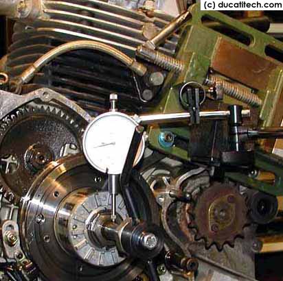

I have seen the bearing in the left cover fair on occasion, most of the time it appeared to be a bearing that had gotten debris in it of simply failed. I would measure runout on the crankshaft and see if you have any up and down movement from the main bearings. Good chance it may only be a bad alt cover bearing.
That said I had two 750's this year with failures of the left side main bearings. Both cases the crank floating cracked the alt cover, one was chunking the main bearing race.
measure things up and look real carefully.

If the main bearing was worn would I be able to feel some slop in the crank? Or how can I check the bearing? I doubt I'll be able to get a dial indicator until I'm home from school. Sounds like this might be a nice winter project.

click for my crankshaft runout page
You can buy those tools for under $40 if you're frugal. Runout usually means the crank is bent. Or on single phase models (pre98) the thin washer behind the starter gear / flywheel part is offset to the center. End float, or play along the shaft is more indicative of main bearing wear.
Personally, I'd remove the nut, check the washer (if a pre 98 model), put in new bearing and try running the engine. But I'm kinda strange...
