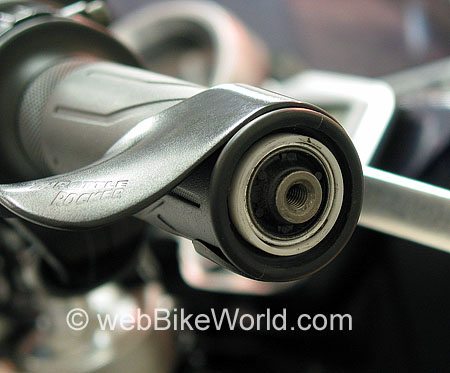

I am finding that after about 1/2 hour my hands (especially throttle) get numb/sore. I try moving them in different positions and have the little flat thing for the heel of my hand. It's just not good. I am planning on installing Dual Star heated grips. I'm thinking about getting different grips while I'm at it. Any good advice on new grips or ways to alleviate the annoying numbness/pain of my present grips (695)?

If your other fixes don't work, you can try to rotate your grip a little bit so it's more like holding a tennis racquet than a baseball bat.  I get the same problem on long rides and this alleviates it somewhat.  Or I'll put my thumb on top of the bar instead of wrapped under.
