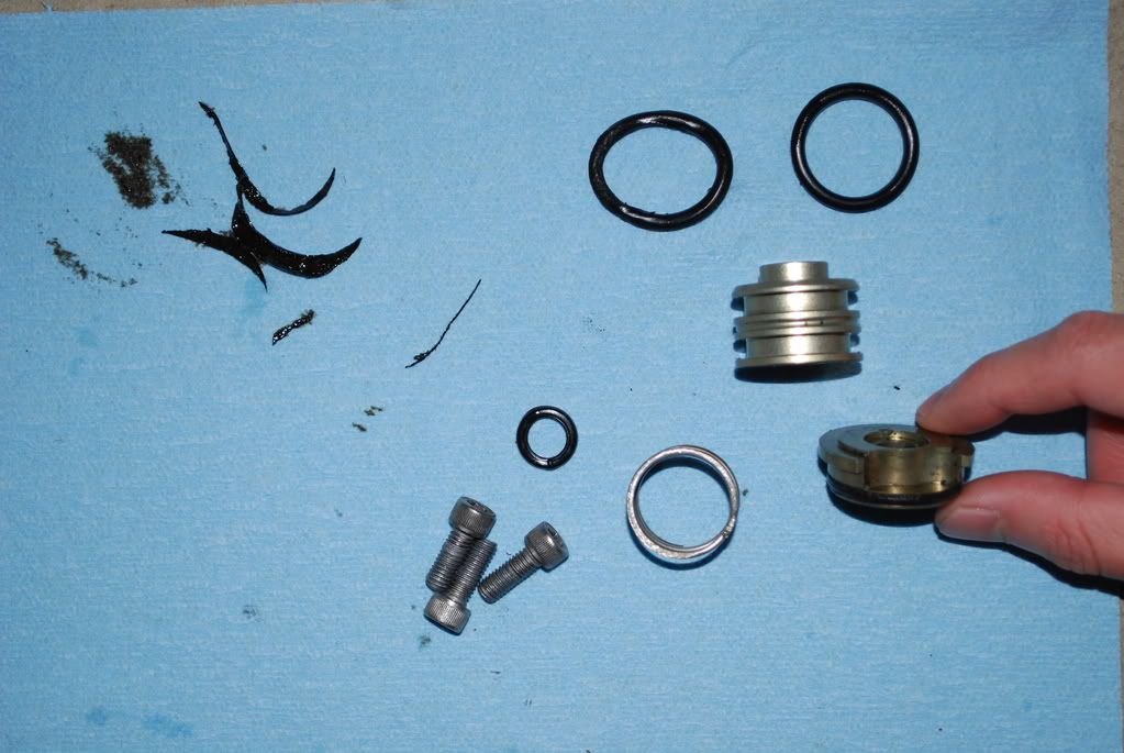

As for the Yoyodyne, I popped it open and it spit out strips of silicon ??? I'm not sure what it was but it came from between the piston and the outer plate. Also the outermost O-ring on the piston (big one on the left) was very distended and there was a bit of black goop mixed up lubricant that I found in the slave housing. I couldn't get my pill out to examine it but it doesn't look too bad. Did I mention that there were gold flakes in the dirty brake fluid that was leaking out of the slave?
off the bike (view image to see bigger)
outa the box
Hopefully all I have left to do is get Yoyodyne to replace it under warranty. Hope that's not too much trouble.

Yoyodyne received my clutch slave and is sending me replacement bits under warranty.  [thumbsup] I really lucked out in that the older monsters need an extender pill between the pushrod and the piston. The pushrod destroyed this and saved me from drilling a hole through the piston w/ my push rod. On top of that they suspect that the O-ring around the pushrod between the slave and the engine broke and let oil into the slave which contributed to the failure of the O-rings on the slave. I can verify this by the fact that the O-ring in question was totally destroyed when I last popped the slave off a couple months ago when my clutch hub nut came loose and I had taken everything apart to inspect.
outa the box
