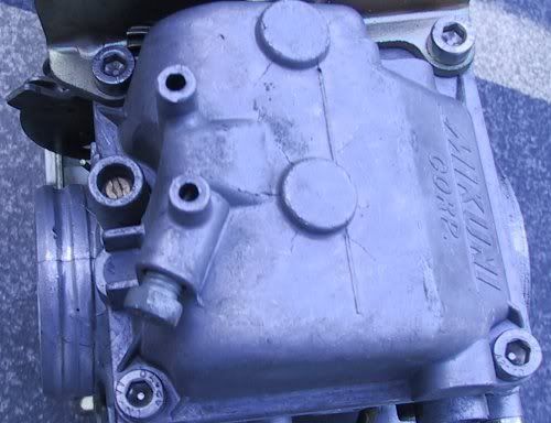

hey guys its me again i have a question how can i regulate the air/ fuel mixture if my carbs doesnt have those screws? my bike is 2000 ducati monster 750 and i have done research about the carbs and i have seen that other ones have those screws and mines dont  :o
jerryz
The air screws are either under the little black rubber bungs are lead seals which can be prised out ..I know as I have a 2000 M750
ScottRNelson
Here's a photo of the carburetor from a 1997 M900.  Yours should look similar.  The brass screw on the left is the idle mixture screw.  It only affects the mixture from idle up to about 1/4 throttle and at low engine speeds.
If you're trying to adjust the mixture at larger throttle openings or at faster speeds, you need to remove the carburetor and either adjust the metering needle or change jets.  There are no external adjustments for those mixture settings.

thank u for ur answer but the thing is that the picture that u show me has the screw, but mine has o close hole there is not even a hole! how did u do to put the picture so i can show u cause i cant put it thanks
Do you have stock Mikuni carbs as in the photo?  If so, they are there, but may be sealed, as described by jerryz.  As I said in the other post, I think you need local help.  Post here:

On one of those carburetors as it comes from the Ducati factory, there is a brass plug over the screw.  I used a drill to remove the plugs from my carburetors, but I'm pretty sure they can be removed using a large sewing needle as well.
In any case, if your mixture problems are in the mid-range or at full throttle, you'll need to do more than just adjust those screws.
