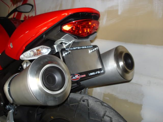

Here is a mock up of my home made tail chop  :)
I have to TIG the indicators on, powdercoat and wire up all the lights
Thought I would give everyone a first hand look-wanted to see what everyone thinks

Looks good!!! if your going to spot tig while the plate is installed, dont forget to disconnect the battery.
 [thumbsup]
While you're welding - weld on a helmet lock? Wouldn't that be a handy place to have one?
OT_Ducati
looks good
just make sure the tire does't hit the plate
when suspension is fully compressed

full compression is something like 4.8 or 5.8 inches. go to ducati.com and check the specs.
needtorque
If you put another 30 degrees outward swing to that plate bracket not only will the plate have enough clearance and still be legible but it will also look a little better.  (aesthetics are important  ;D )

I think I will bend the plate outwards-the rear tire clearance is at about 3.5" (specs say 5.8")
Thanks for the welding tip-I will remove the whole assembly for welding

Here are a couple of pics after welding and bending the plate up
Still have to powdercoat

Nice job! Do you live in Canada (I think I saw a Canadian flag). Do you have reflector issues where you live? In CA, seems like a lot of riders are getting fix it tickets if they don't have reflectors around their plate.

that looks great and the final angle of the plate looks very good for the bike.

Yes, I'm in Toronto, Canada (we are just getting some warmer weather)
I haven't heard anything about reflector issues but I plan to install reflective rim tape in the very near future

If reflectors turn out to be an issue, the vertical space above the license plate and between the turn signals looks like the perfect place to stick a long rectangular one.
