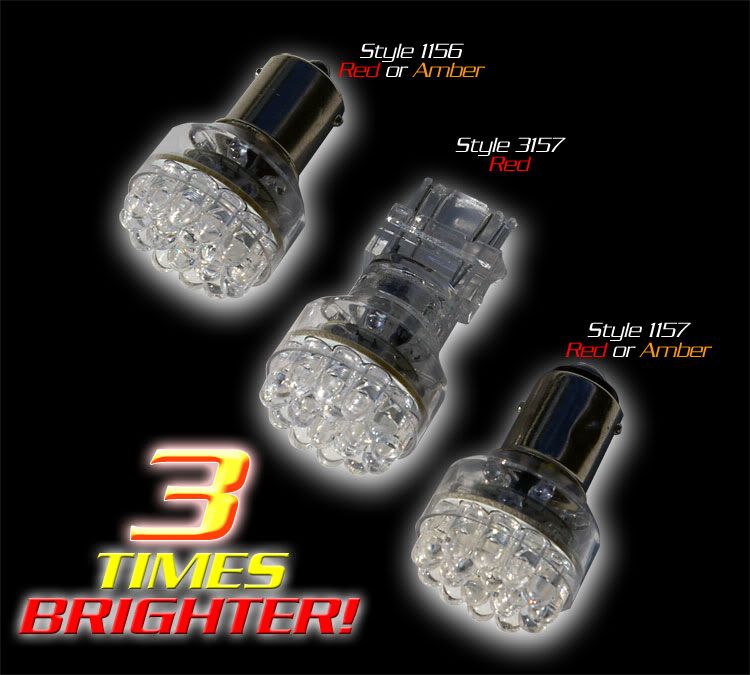

            Dear Ducati monster brainstrust
   ^Anyone used or had experience with these ? ^
      Quoted price US$6 +US$20 POSTAGE
   Or are they available here at a competitive price ?
  After installing a LED tail/brake light on both bikes I have noticed
         that they are so bright the OEM indicators
              get lost and are hard to see.
I quite like the original Monster indicators ,IMO they suit the bike as I find a lot of the aftermarket
LED indicators are too small and look to angular and modern on such a classic old school bike  [thumbsup].
So I would prefer to keep them but get brighter  8) .

So let me get this right, you want to use these bulbs in your original indicators?
If I'm thinking right(seldom), the LED bulb would be facing 90 degrees to the lens, then it would'nt work 'cos LED's need to be facing outwards, like your stop/tailight is facing, if that makes sense.

The bulbs you post look more like tail light globes though and not indicators.
I had an LED bulb in the tail for a while but found no real brightness difference.
Though they are extremely pricey you might want to have a look at Kellermans.
They have a similar mini shape of the classic indicators and are the brightest things I have ever seen.

Quote from: monstermick58 on December 06, 2010, 08:36:30 PM
Ahh Mick now that is a light bulb moment
Your clever  [thumbsup] why didn't I see that
Thanks for saving me $46 I owe you a  [drink]

I think you will still need to install resistors if you use them for indicators,
not just plug and play. :-\ ie flash too fast :-\

Why not something like http://www.cutter.com.au/products.php?cat=Cree+XRC
In amber.
Then just add a resistor in series, and mount them to a bit of aluminium inside the blinker...

I tried that kind on my S2R and IIRC they didn't blink fast, but known results are all over the range...
(it just might have been one test buld. 2 or 4 might be different)
There is one serious problem - it's too big for the lens to fit over it. (oval blinkers)
Also, LEDS are usually very directional, they don't use the reflector to spread the light and will be hard to see at an angle.
Two dogs
Thanks for sealing the casket on this plan stopintime
hmmm now what's plan B  ???
