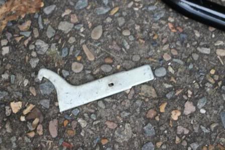

I had an old C spanner kicking around....it was a bit small, came out of a VTR250 Tool Kit....to do what, I am unsure. Anyway, a bit of a hacksaw later, 1 working C spanner....enough to tighten the chain anyway.

The "C'ish" Spanner !!

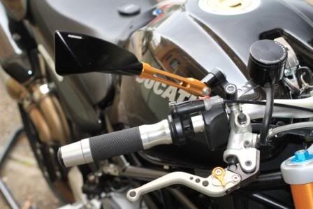

OK, important question though, where did you get those mirrors from? I've looked on the sites I know and can't find them like that?

Quote from: Sundog on August 15, 2011, 10:14:02 PM
2 minute search....(easy if the brand was in focus)
http://www.motovationusa.com/mvstore/scripts/prodView.asp?idproduct=531
http://cjmoto.com/-strse-24/Rizoma-Mirror-Tomok-billet/Detail.bok
I have seen some Chinese rip off's on Flea-bay which look identical....besides the Gold is a little bit much
http://www.ebay.com.au/itm/Ducati-Monster-S4R-S4RS-M620ie-M750-M900-Gold-Mirrors-/300583138430?pt=AU_Motorcycle_Parts_Accessories&hash=item45fc26b47e#ht_5973wt_1121
Glad they have some "Bling" Factor......as their not so great in the "Mirror" Factor
