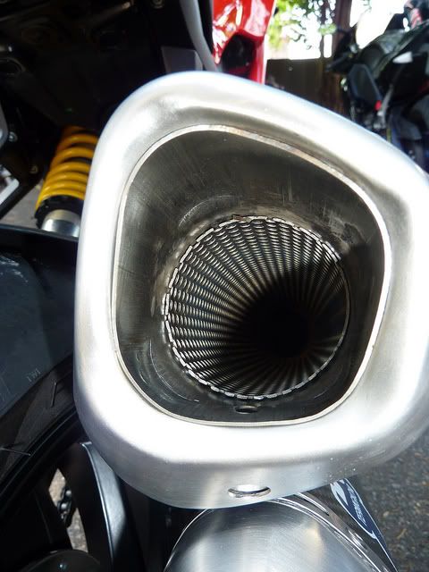

Here is a pic of one of my cans below....3 month old Termi's. Picture doesnt show it but the perforated chamber runs straight through with no partitions.

Mine are just like Lukevo's, they're nearly two years old and straight through as well. Are you 100% they are genuine Termi's?

looks like stock cans from when i did my 916 cans
i do recall my mates 998 with stock pipes had the termi logo on them
so doesnt mean that they arent termis just not free flowing termis

dp sold listed termi "approved" mufflers for most models.  not sure how many they actually sold.  that's what they would be.
