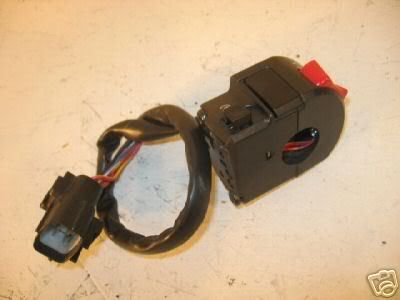

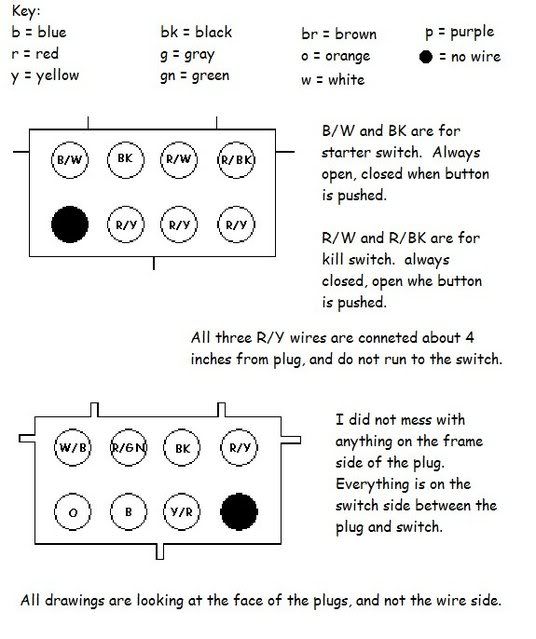

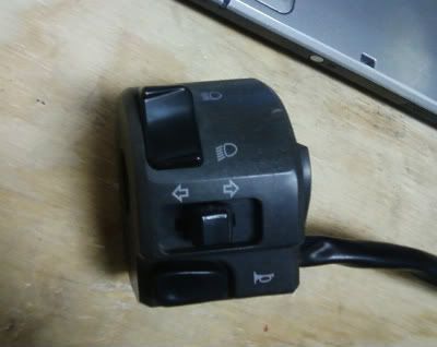

i only have a start button on the right side of my bars, and a small "off road switch" on the left side.  the left switch handles the lights (off-low-high) horn, and blinkers, but i dont have the blinkers wired up.  i have a home drawn wiring diagram that i did if you want that.  im not sure what year bike you have, but mine is a 04 m800.  i can give you a pic of the switches i took off so you can compare to what you have right now.  if you want, im sure it wouldnt be too hard to set it up with just a button on the left for start, and two buttons on the left, one for the horn and a click button for the high-low.
i have not used blinkers for the last 3 years, and so far ive had no close calls. *knocking on wood* but i would really hate to loose the horn.  it has saved me several times.  give me a few minutes and ill get those pics up.

all of the drawings are looking at the plug, where they plug into each other, not where the wires come out.  im not sure how most wiring diagrams work, but i did this on my own and i understand it.
left side.
right side.
i did all my wiring between the plug and the switch.  i did not want to cut into the regular frame side of the wiring harness.

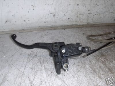

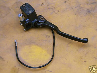

i still have the stock master cylinders and reservoirs.  the problem is that the stock "coffin" reservoirs (at least thats what i believe they are called) are too big to fit on the vortex clipons with the stock switches.  and i know i could change the switches for less than the cost of changing the reservoirs.
i have found (through the power of ebay) some pics of what my stuff is.  the only pic that is actually mine is the left switch.
my original left switch.
my original right switch.
coffin reservoirs.
while reading the description for some of the other euro switches on ebay they say "The switch will fit all Ducati Monster 620/800/900/1000 motorcycles 2003 and later." so i assume the wiring i posted earlier will work for all monsters '03 and later, but i take no responsibility resulting in damages and/or problems from the use of my diagram.
